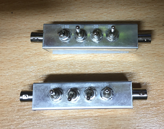

Behuizing: Box73
Schakelaars: pcf-electronics
BNC connectoren: amateur radio shop

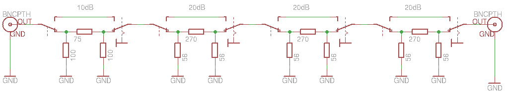

Schema:

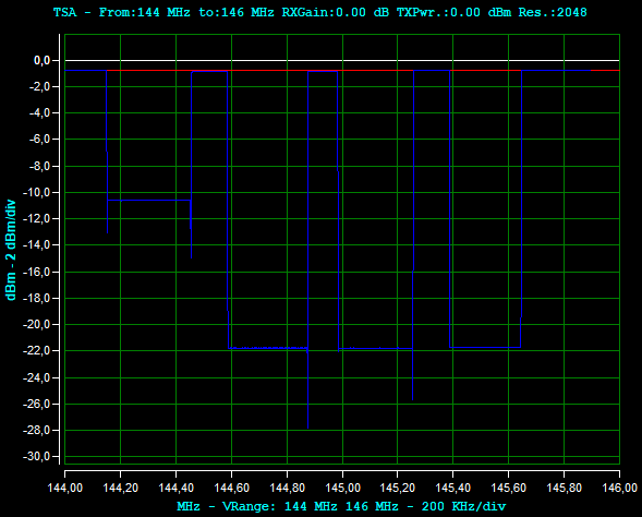

Spectrum:

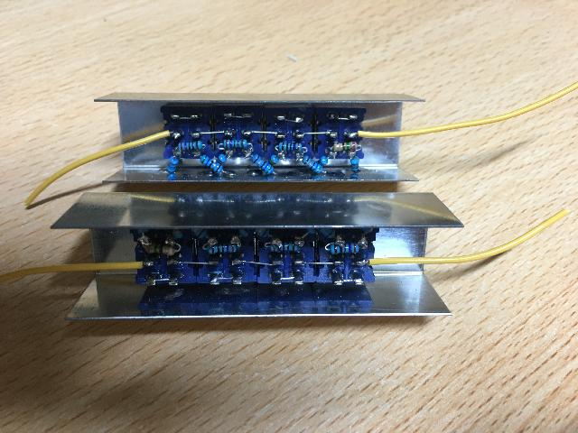

Binnenwerk:
